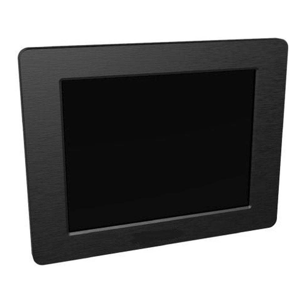

                        ¿Pantallas rugerizadas para exteriores?
                        Semi-rugged 8" Sunlight Readable LCD with IP65 rating, 4:3 aspect ratio. The SunVu 8XPM is a semi-rugged 8" LCD display designed to deliver exceptional performance in outdoor and vehicle environments. With a native 800x600 resolution (sync up to 1920x1440) and a 4:3 aspect ratio, this sunlight-readable screen features
                        Y podemos mezclarlo con ordenadores, Arduinos, Raspberrys Pi, software de todo tipo como openplotter o Navigatrix, móviles, tabletas, Radomos de radar 3G, televisores con entradas HDMI, pantallas exteriores con entrada HDMI, WIFI, BT, escritorios y controles remotos Etc.
