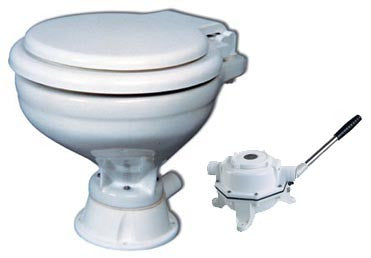

                      Sabe alguien por que se venden en algunos sitios todavía los Lavac? en otros sitios pone que se dejaron de fabricar en 2006..
                      Lavac Popular Toilet. Available to order now with Worldwide delivery. “The Worlds Most Reliable Sea Toilet” With its vacuum flushing and no moving parts, the Lavac toilet has earned the reputation of being a reliable sea toilet. After use, simply close
                      Lavac products are second to none when it comes to reliability Operating with a highly effective vacuum system that simply works as is has done for
                      Tal vez sea que los que se dejaron de fabricar sean los modelos Zenith, los Popular parece que siguen vendiendose..
                        Re: Inodoro Marino o WC quimico?
                        Se siguen vendiendo si.
                        The "Popular" model is the third generation Lavac, the latest in a long line of fine marine toilets extending back to 1963. Like all Lavac Marine Toilets the Popular Model has a high quality porcelain bowl and is powered by a heavy duty Henderson Mark V type diaphragm pump. The Popular has been engineered to reduce cos
