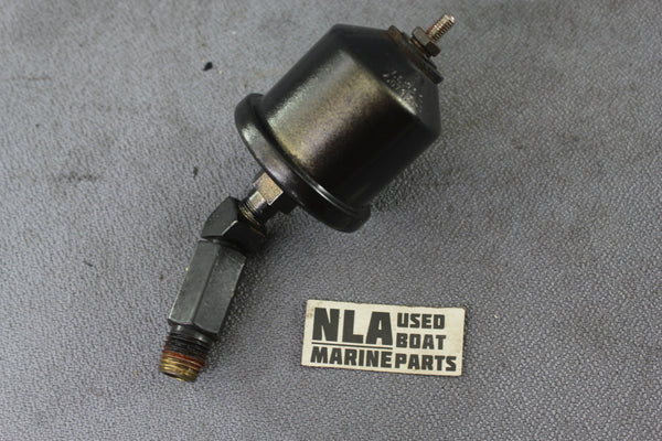

        Re: Motor Mercruiser 454 Magnum
        En los V8 350 está al lado del delco en la parte izquierda del motora babor.
        Tiene esta forma
        Part Number(s) Included MerCruiser 815425 Oil Pressure Sender MerCruiser 22-29085 (45 degree Elbow) MerCruiser 22-805059 Fitting General Application / Compatibility The sender was used on all sorts of stuff not listed here, but the fittings (which could be removed) are specific to 454 / 496 Bravo applications and some
