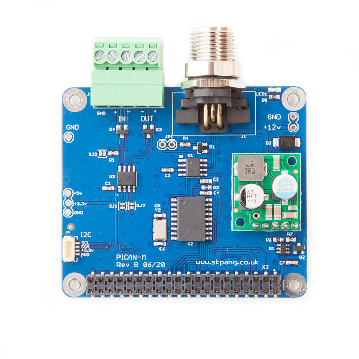

        Personalmente me decidi por integrarla directamente en la raspi con un HAT (hardware on top ) que saca directamente el terminal de 5 pines de las nmea 2000 clavandose en los pines de la raspi. Es la tarjeta Pican-M .Tambien permite alimentar la raspi desde nmea directamente aunque uo no lo uso.
        te paqso link
        NMEA 2000 This is a PiCAN-M with RS422 and Micro-C connector. The RS422 is via a 5 way screw terminal. The CAN-Bus connection is via Micro-C connector. This board includes a 3A SMPS. The 12v is from the Micro-C network can be use to power the PiCAN-M and the Raspberry Pi. Metal case for PiCAN-M and Raspberry Pi 4. Features CAN connection via Micro-C connector 120Ω terminator ready SocketCAN driver appears as can0 to application RS422 via 5-way screw terminal appears as ttyS0 to application LED indicator (GPIO22) Qwiic (I2C) connector for extra sensors Include 3A SMPS to power the board and the Pi from 12v line. Compatible with OpenCPN, OpenPlotter, Signal K and CANBoat Documents Schematic User Guide v2 Distributors United States and Canada Copperhill Technologies Europe Germany Optional metal case. Raspberry Pi not included. Photo above shows GPS with RS422 connection and BME280 Atmospheric Sensor with Qwiic connection. (Other hardware shown not included). Photo above shows GPS device in use with OpenCPN. Photo above shows PiCAN-M board connected to a CAN-Bus network. (Other hardware shown not included). Photo above shows temperature reading from a Yacht Devices Digital Thermometer YDTC- 13N on Signal K instrument panel. NMEA 2000.
        Espero te sea util.
        En mi caso funciona perfecto.

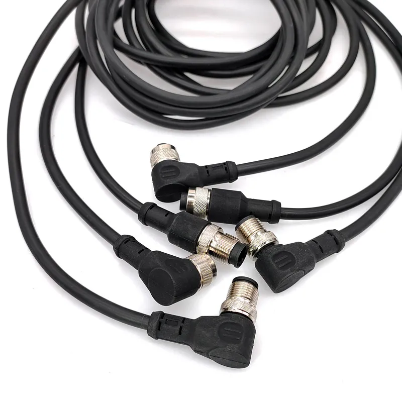

        Por cierto compra los cables nmea 2000 (conector M12 de 5 pines los llaman) en aliexpress por menos de un tercio que aqui con los conectores puestos.
