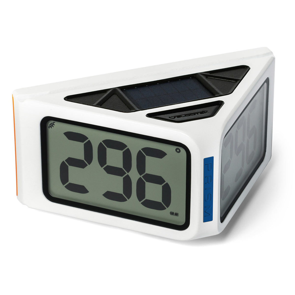

                        Re: Equipo viento real sin corredera
                        Exagerao, exagerao ...
                        500 ... el Compás magnético de Números gordos
                        Buy Velocitek Prism Wireless Magnetic Racing Compass, sailing gear, sailboat parts, sails and running rigging at Vela Sailing Supply. Technical support, customer service and product information. Vela and sailing supplies.
