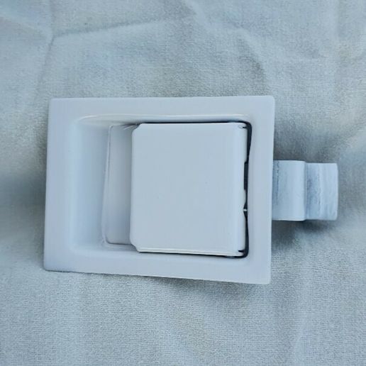

                                CIERRE ESCOTILLA Trojan Express boat latch 390 400 440
                                Part made from original model present on Trojan Express 390 400 440. Adapted for on-board opening system. Printed on the photo in black then painted white. Ideally, use a filament close to the original color of the part.
