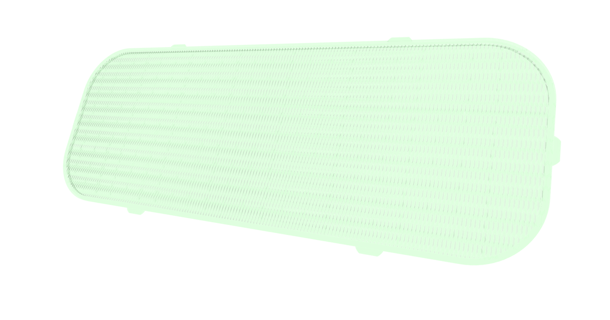

                                MOSQUITERA EJEMPLO Portlight Flyscreen Lewmar's Atlantic Size 32
                                Flyscreen for your yacht's portlights. Keeps bugs out, reduces the amount of rainwater that gets in, increases privacy. | Descargar modelos STL imprimibles en 3D gratuitos
